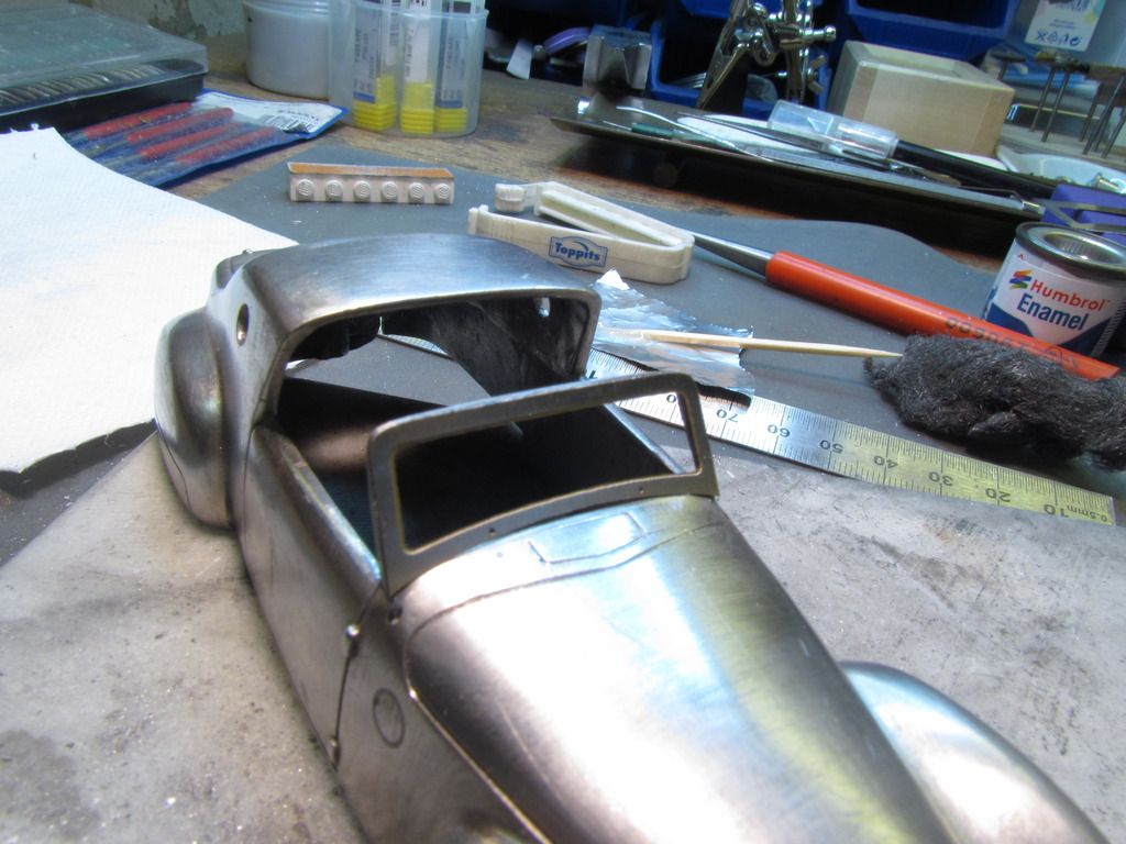

And to show that "sh... happens", I want to show following problem:

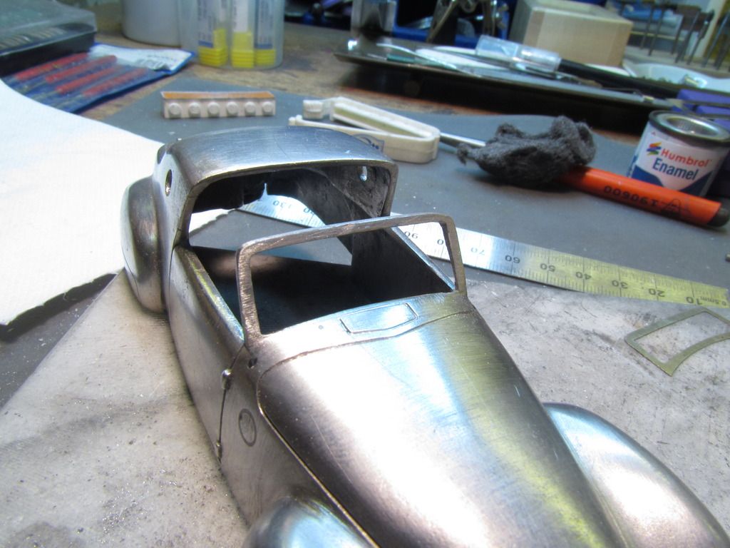

The frame for the flat windscreen is flat at its top edge, but was curved to the front at its lower edge. When filing this curvature down, the material got so thin that it was torn off:

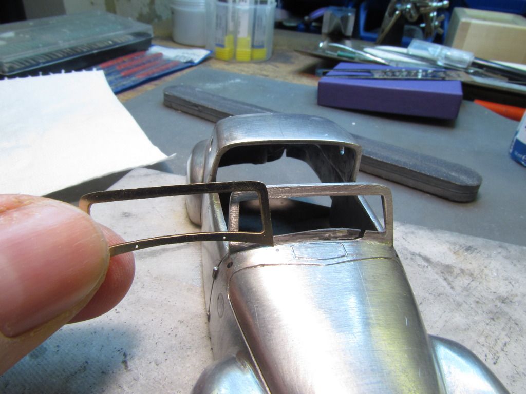

Quickly designed a matching frame and photo-etched it:
"Cleaning" the existing frame:
Glueing the new frame onto:

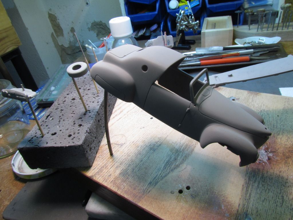

Smoothing everything with putty:
... and already (finally... :) ) priming all parts:
