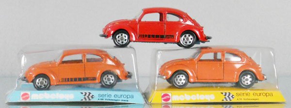

I would like to purchase a couple brand new (yet almost 50 years old) Mebetoys cars. The only problem is that they have the hideous "Fast Wheels"-type wheels on them. I'd like to swap out the tires/wheels to some that are beautiful as opposed to ugly. How hard is this to do? Do any of you do this to vintage cars regularly? I've read about a person on here swapping out one wheel set for another and it was beautiful to see. Any experience doing this to cars that are half a century old? And if so, any tips?

It depends on how the models are put together. Some are riveted, so it's a question of drilling the rivets out and afterwards glueing the model back together as well as possible. If they're held together with screws or clamped (usually with the bumpers holding the base on) it's a lot easier. You'll have to source appropriate wheels and axles and perhaps have to modify the base to accept a thicker axle. Personally I hate taking apart riveted models- it can be tough to get them back together properly.

I have only done a wheel change on two Politoys Lamborghini Jaramas (both purchased in the late 1980s) which from memory only came with horrible one piece plastic 'whizz' wheels.
In Europe as far as I'm aware the Politoys Jarama was only available in Red with matt black bonnet and boot, or silver with similar matt black bonnet and boot. That Politoys didn't make a decent job of the Jarama like they did for their other Lambo 'Export' Series cars was a shame. I blame the acquisition of the Italian company by Mattel/Hotwheels for the 'dumbing down' and cheapening process which was partly driven by fashions of the day when whizz wheels were all the rage on 'toy' cars.
Proper moulded metal wheel rubber tyres for this 'orphan' came from chipped and beaten up Lamborghini Export Series I Espada and Miura sourced from Toy fairs for a very low price.
As Politoys and Mebetoys of the period cars mostly had screw on bases it was relatively easy to take them apart to make the swap. I vaguely recall buying the correct gauge metal rod, cutting it to the right length and then 'burring' the ends over. Unlike Dinky and Corgi which had thick axles the Politoys cars had much thinner axles.
The wheel swap made for a complete transformation. Somewhere I have digital pics of the pair of Jaramas with their new wheels.If I can locate my old pic I'll post it here. I may be gone some time....

What is the specific Mebetoys model ? Many of the cars that ended up with 'wizz wheels' were earlier produced with cast wheels, so you may be able to simply swap base plates / chassis if it existed as an earlier standard wheel model.

Jager wrote:What is the specific Mebetoys model ? Many of the cars that ended up with 'wizz wheels' were earlier produced with cast wheels, so you may be able to simply swap base plates / chassis if it existed as an earlier standard wheel model.
That's exactly what I'm doing: swapping out the FastWheels on a Mebetoys Alfa Romeo Duetto for normal, nice looking wheels from the exact same model (a junked one that I bought for 25 Euros solely for that purpose).
