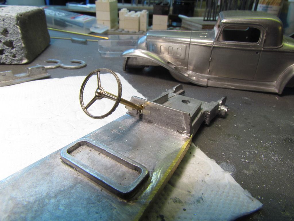

And you can replace almost anything by photo-etched parts :roll: I indeed had some ideas making base-plates and chassis for scratch-built models this way...

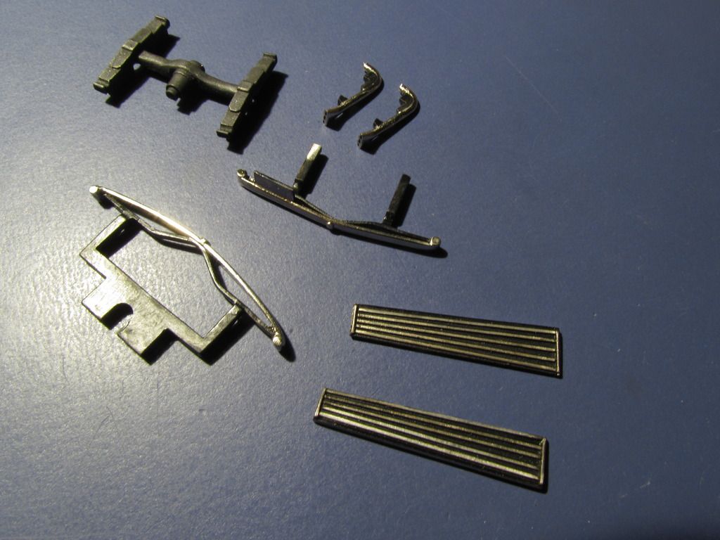

This time a photo-etched part serves only as a template for scribing an exact pattern of side-vents into the bonnet:
Steering wheels I meanwhile make generally with photo-etched parts. I think they get much finer this way and you can detail them according to the original:

The template is a nifty idea. Steering wheel is a huge upgrade, much more realistic like this.

In future I think I'll use more templates like this, because it's quite difficult to scribe lines into white-metal. No matter how carefully you work, the material is so soft that you easily slip away with the needle and sometimes it's impossible to correct the lines then...

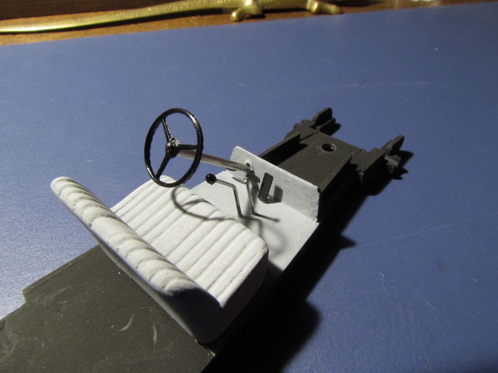

First example of a ready-made wheel, front and back:

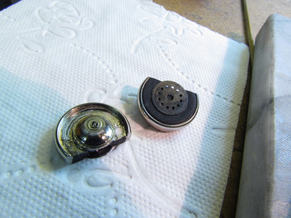

... and the spare wheels:

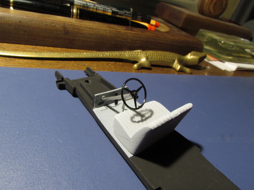

Construction for steering wheel, steering column and pedals (have a closer look):
Now all the parts are ready for priming:

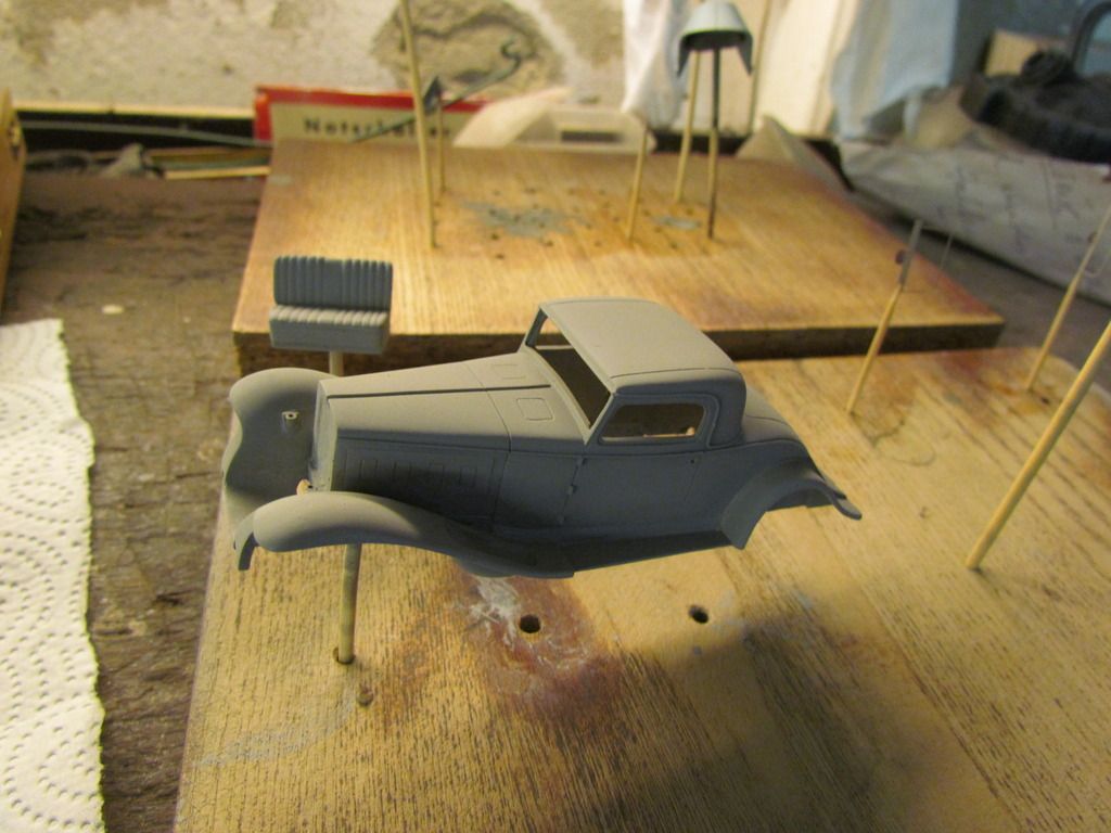

... and I've used again enamel painting :roll: ! The first tests I made with acrylic paint revealed a kind of "latex" layer, even if sprayed very, very thin. This looks a little "fat" and is nearly impossible to sand/file. I guess I'll continue with the tests, as it is very easy to work with acrylic paints, no smell and cleaning can be made with clear water.
However, first coating with enamel primer is done, and the bodywork looks quite tidy:

The body looks much sharper now. I like the pedal arrangement, quite unorthodox.

Tom wrote:The body looks much sharper now. I like the pedal arrangement, quite unorthodox.
I simply tried to repeat the original arrangement, but I think it works:

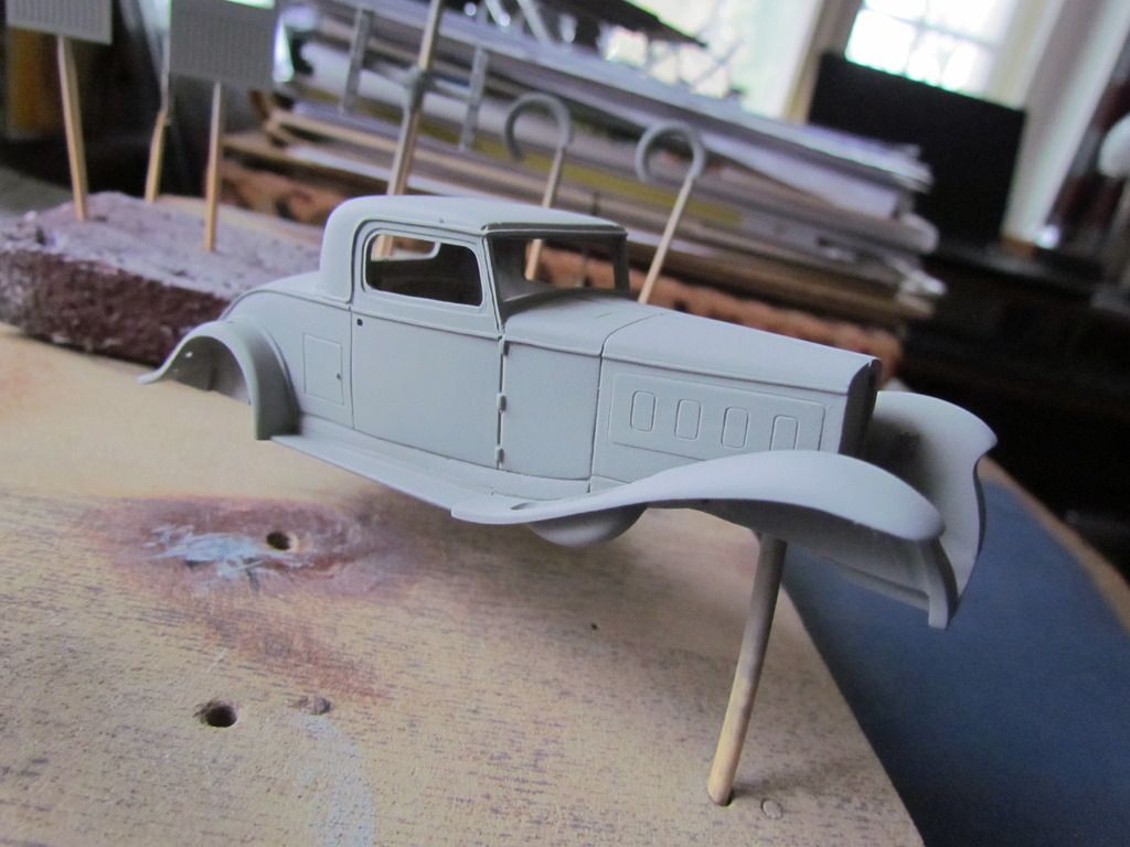

I love the "primed" models, I'm always tempted to keep them that way because in this condition you can recognize really any single detail and the full beauty of the design:
ImageNow with second coating. And tomorrow will be the great day spraying the first layer of the final lacquer. Hope you'll be surprised... ;)

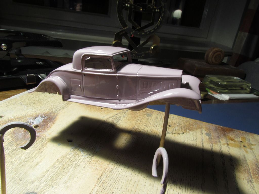

Main work for today - airbrushing the first coating of lacquer. And - tadaaa! - it's mauve (the shade of old ladies' hair :D ):
This first layer is very thin and therefore rough-surfaced. This way all edges stay covered when airbrushing, and the rough surface gives a good "grip" for the next (final?) layer.

Oops, seems as if I had put you all to flight with my colour choice... :oops: However, I'd like to show the progress of the Marmon. Today I've airbrushed the third and hopefully final layer of paint:
This should be enough for smoothing and polishing.

Spare wheels as well:

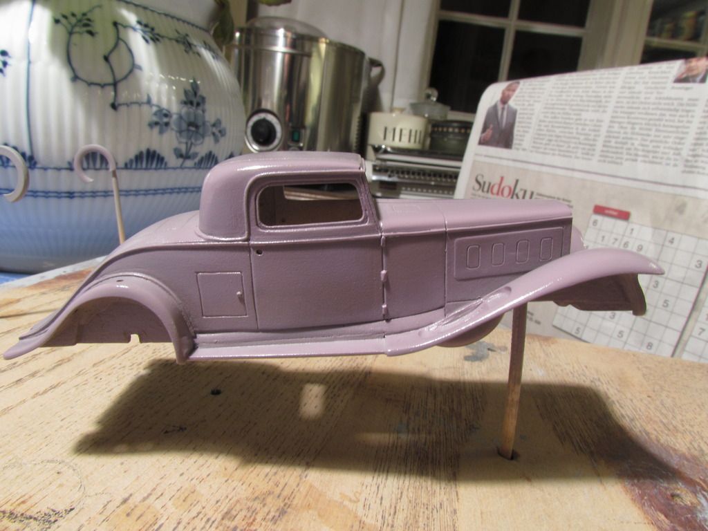

Bodywork has been polished:
Im not fully satisfied with the painting, the surface finish of the last models turned out quite better :( Well, in Germany we say You are not in it if you don't know why something went wrong ;)

Am interested in how you correct the paint, looks to have a bit of an orange peel surface?

...at least I hope so! But no, NO repaint :evil: ! I'll leave it the way it is. I guess sometimes you simply have to go with it the way it is, haven't you? :)
stewil wrote:The dash is stunning Jean and it appears you used a new technique, ie, the rings are more of a true bezel now. Beautifully done. Kudos to you. Am interested in how you correct the paint, looks to have a bit of an orange peel surface? Also, how do you affix the wooden stick? to hold the model? Looks pretty solid.
Have a look at the pictures below, showing the car/paint under daylight. I simply leave it this way - not perfect, but still o.k.

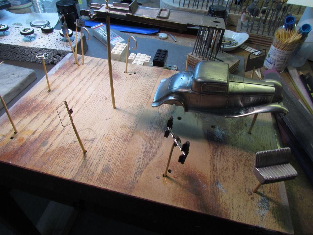

The wooden stick is simply "screwed" into the screw-hole of the body. Of course this doesn't match all the time, sometimes the bodywork is too heavy, then I apply metal putty under the bonnet or the trunk, drill a hole into and glue the stick into the hole, cutting it off when being ready with painting.
