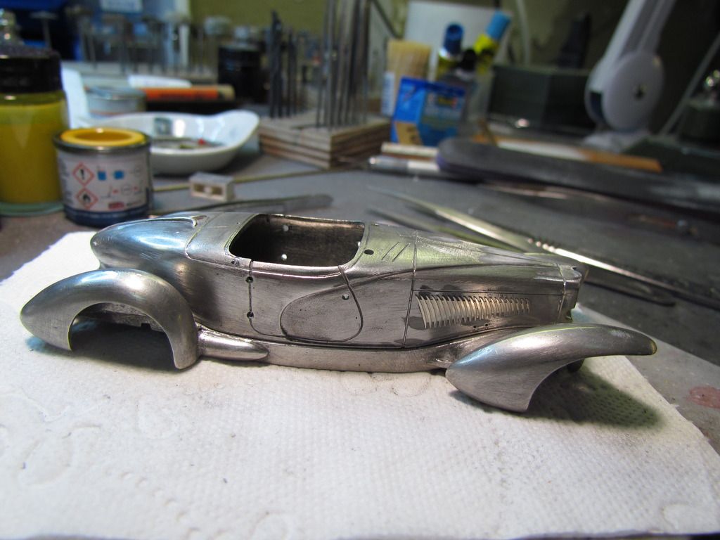

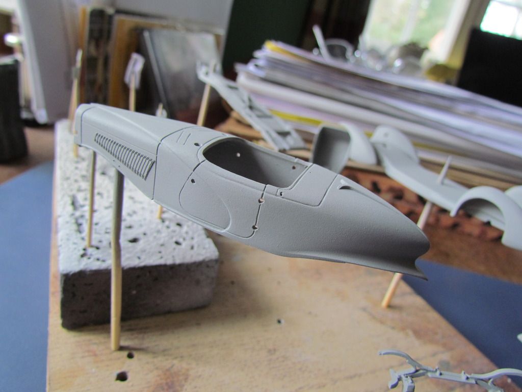

Finally it was quite easy, but at the beginning it cost me several sleepless nights... :roll: For not only making "Wieners", but to get louvres which almost have a real "shape" my knowledge in graphic design comes to its edges. Therefore I turned the original photo diagonal, because it was much easier this way to work with upright louvres...
Finally, photo-etching was made with this result:
Old louvres milled off:
...and the new parts glued onto the bonnet:
To finish the day, a first coat of primer was airbrushed:

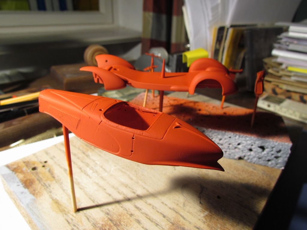

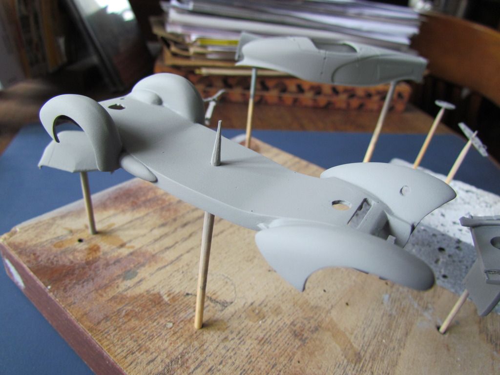

After retouching some small spots and blemishes, a second coating of primer was airbrushed, and it looks pretty nice now:

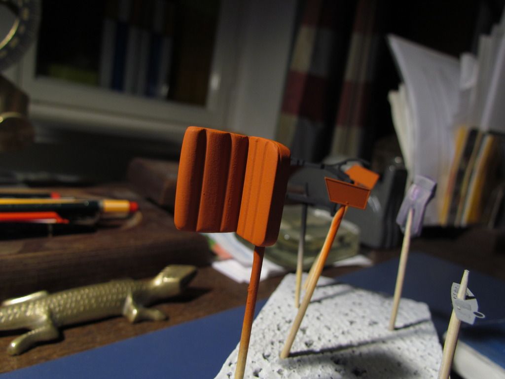

After having bought some new cans of yellow paint, it seems that it works this time, although the shade is not yet satisfying... :? ...still a little bit too green. Tomorrow, with some daylight, I will put some more orange into and spray a second layer.

No, that's not the final painting! Yellow paints do not cover dark primers very good, that's why the last painting seemed so dirty-greenish. So a white-based foundation is necessary before using a yellow paint. This has been done now:
Within the next days (I'm a little busy at the moment) I'll airbrush the final bright yellow ("sunflower")...

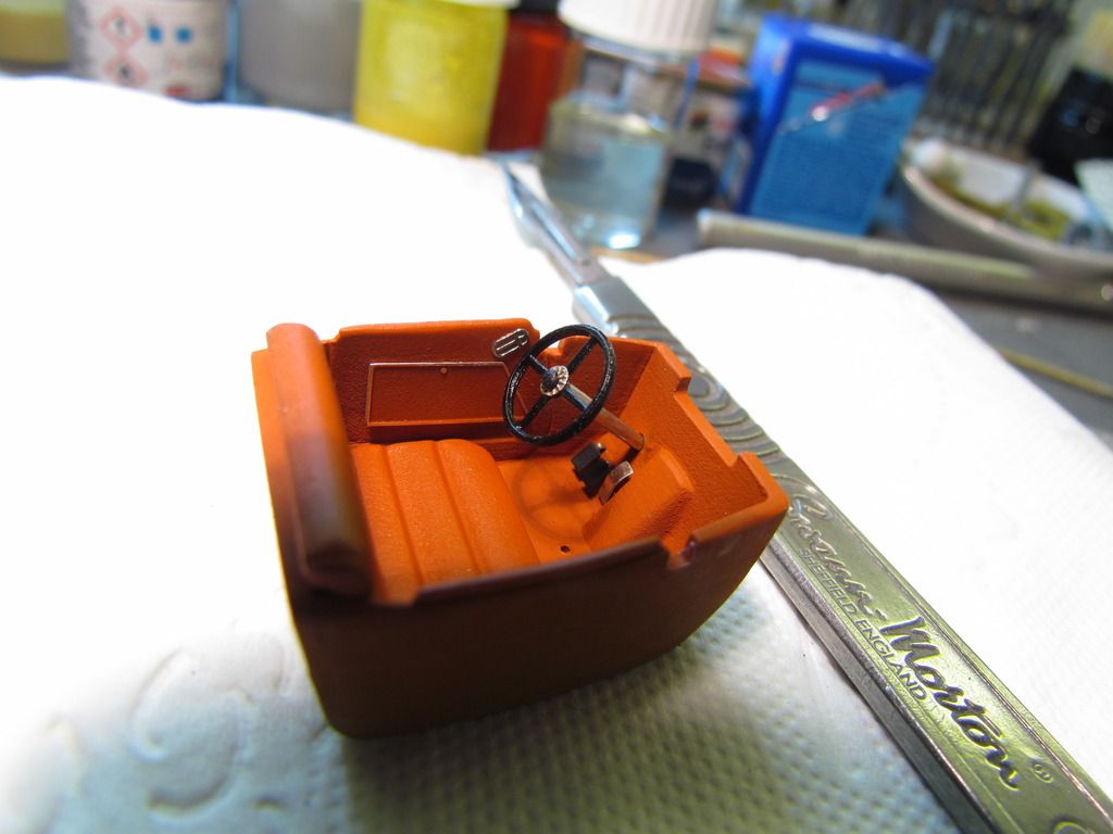

And this - a red-brown - is the colour for the interior:

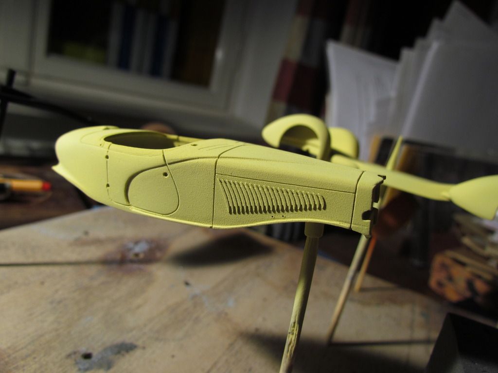

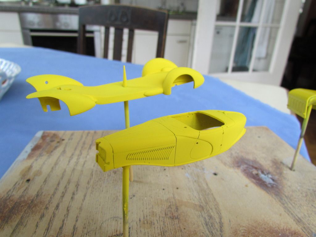

Yellow - finally - finished:
Hood is ready:

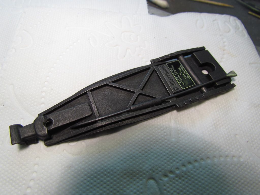

chassis as well:

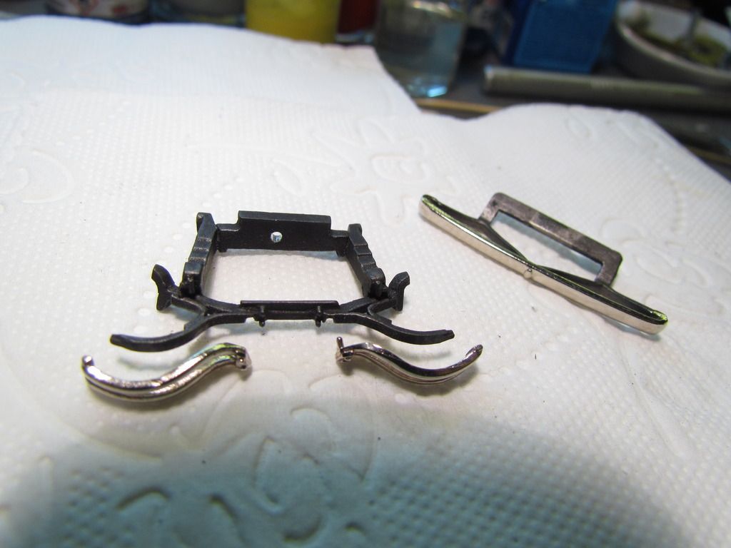

and bumpers are prepared:
interior, of course still without dashboard:

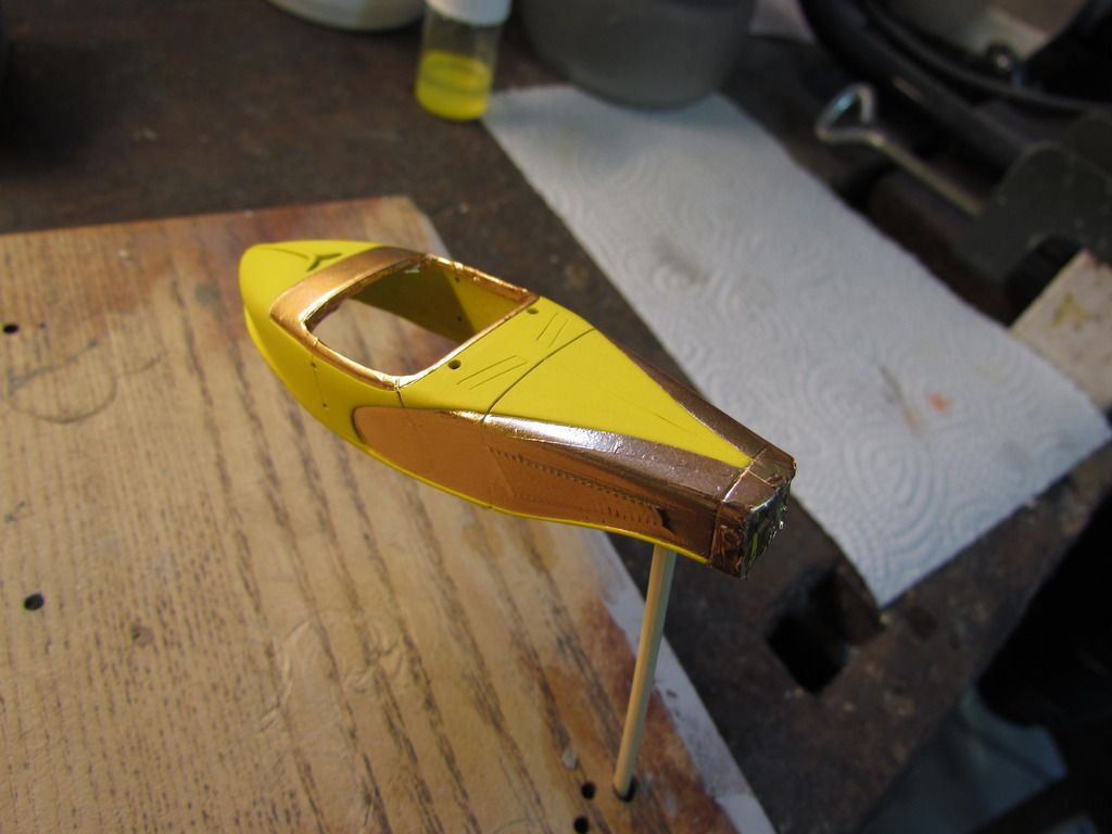

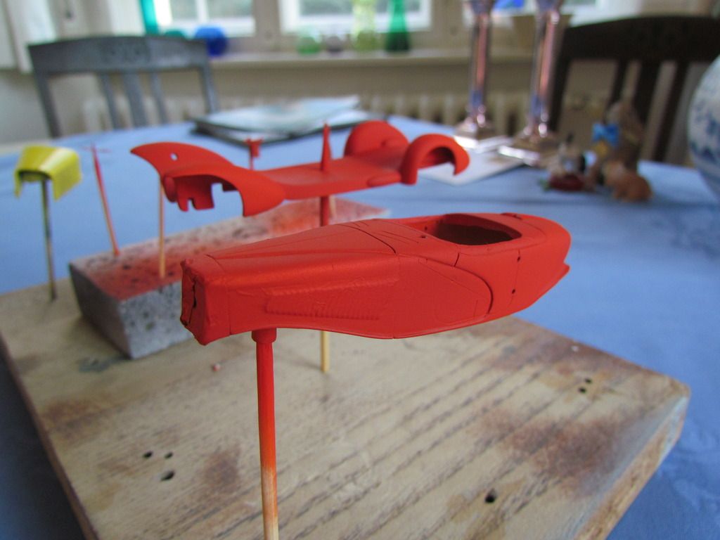

I mainly didn't like two things with the original painting: The red was too "blueish", and the bright red and the creamy yellow didn't "go together". When studying the car, I felt that this was a real "fun car" - think of the compartments for Bourbon & Cigars - IN A CAR :mrgreen: , so I can imagine that the colour scheme was "fun" as well. Furthermore, in those days they worked with paints pigmented with cadmium, chrome and lead oxides, which are prohibited nowadays, but made colours so intense and bright we can hardly imagine today. So I decided to make a "brownish" red, an adequate yellow, and both flashy. Here's the preview:
masked with BMF (terrible work, you simply cannot see where you're cutting as the blade and the foil are sparkling the bet:
...and airbrushed red:

Today there is not so much to see, the second layer of red paint had been airbrushed, it looks - under daylight - a hue darker than before (photo is taken under a desk lamp):

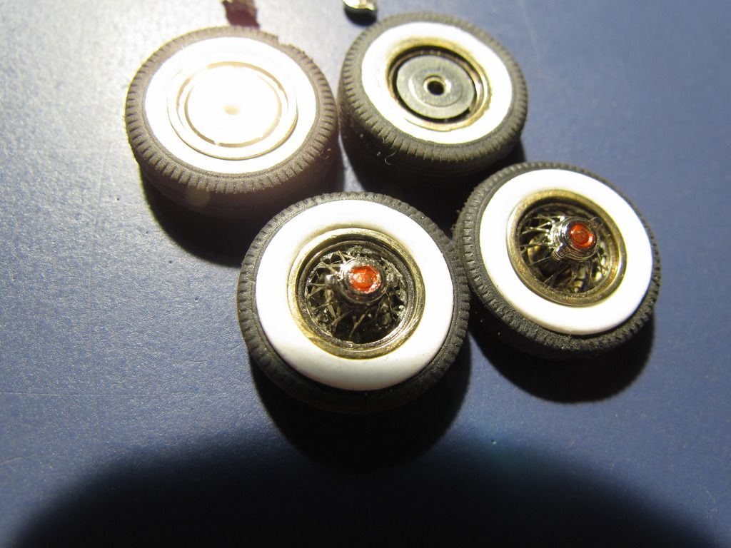

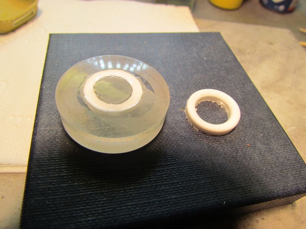

I casted some new whitewalls:
The rear of the tires had to be painted white, small Cord logos are applied on the hubcaps:

Fantastic detail in those wheels alone. Your home-made tyres look superb.
