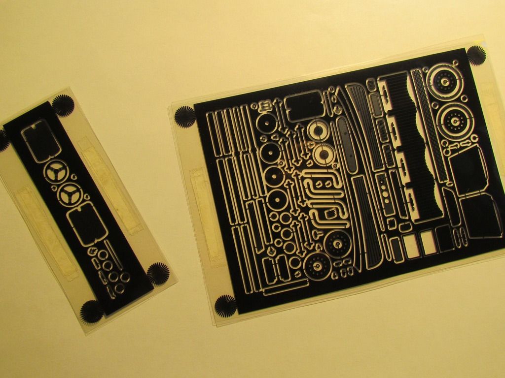

I remember starting photo-etching with the two Duesenberg "J", windshield and mascot, that was all! Meanwhile the Maybach needs the largest sheet I've made so far:
I really hope that everything works :) ! Of course I'm quite experienced meanwhile, but for photo-etching you always need some luck, as every single step (making the films, exposing, developing, etching) bears some danger... Tomorrow I'll do it, and of course I'll keep you informed ;)

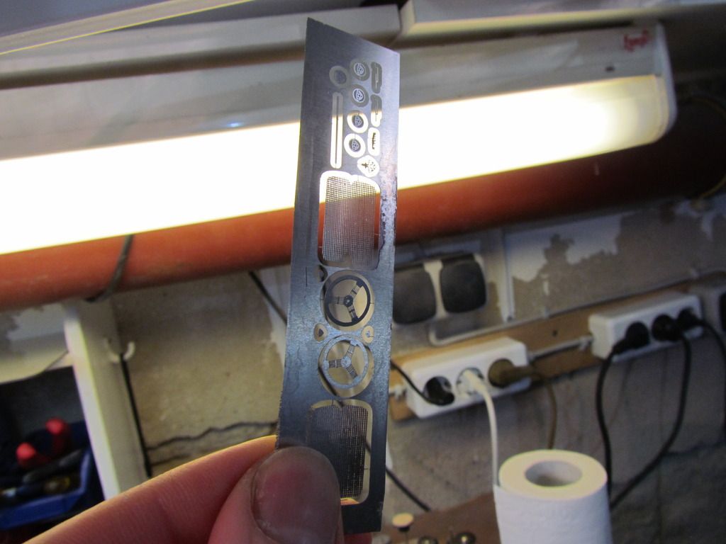

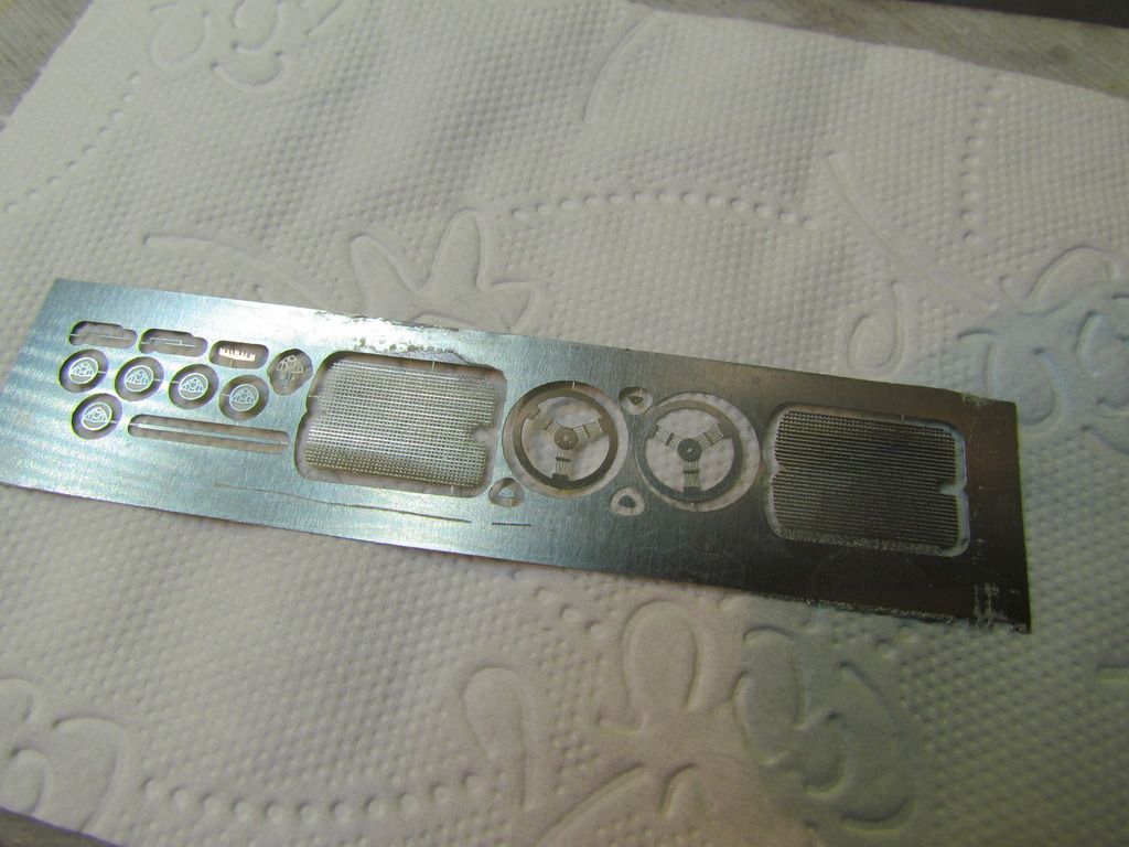

Here we go: First the 0.1mm sheet with only a few parts
Have a look at the radiator mask, the holes are about 0.1mm:

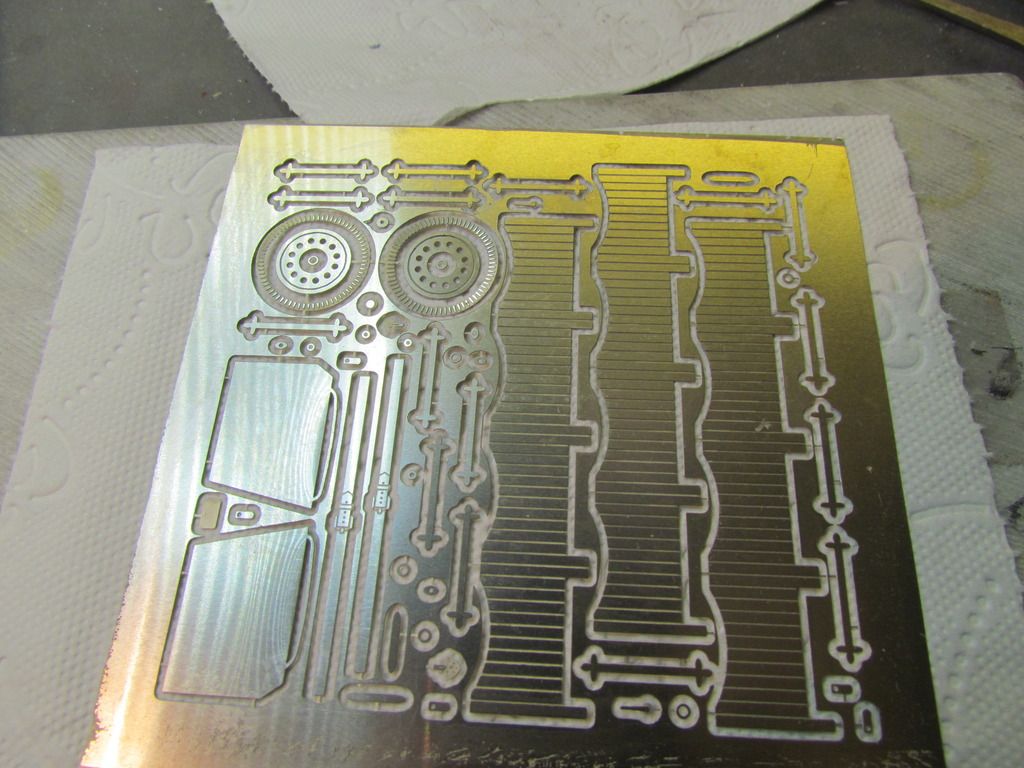

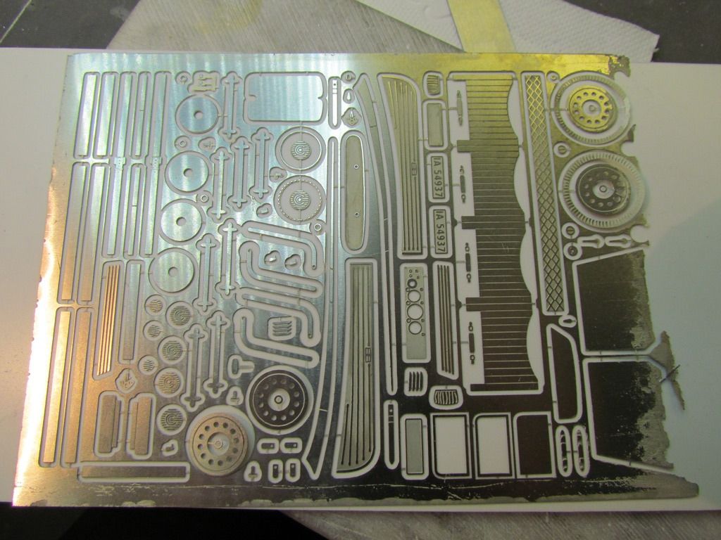

When I grab the 0.2mm sheet, I didn't notice that one edge was not covered properly with the UV-lacquer, resulting in a completely burnt edge and destroyed parts in the upper row :( :
At least I'm very satisfied that the difficult parts, e.g. the beltlines, fit perfectly! :P
So I immediately started again, repeating only the failed parts and added some further for my diorama, and this time the result is perfect :oops: :

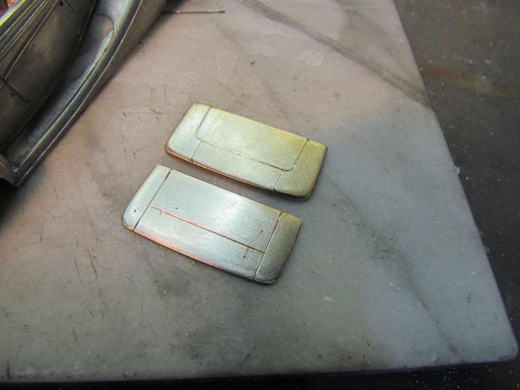

First I've made the new persenning a second time... :roll: I wasn't fully satisfied, and so I took a slightly thicker sheet (1.5mm) and scratched the lines more authentically regarding the original car:

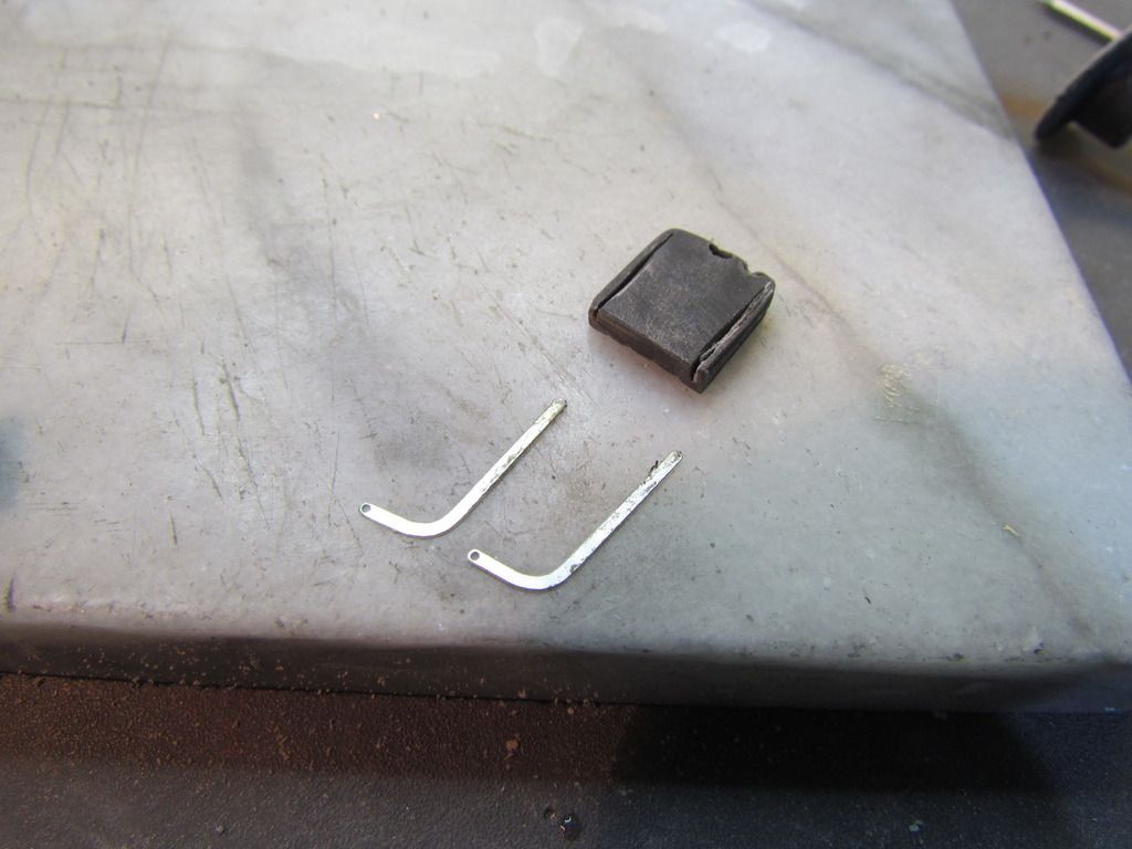

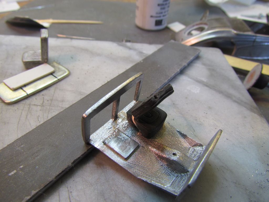

Wouldn't it be nice to have this in the model, too? So I've made resin copies of the seats to try all the necessary steps first:

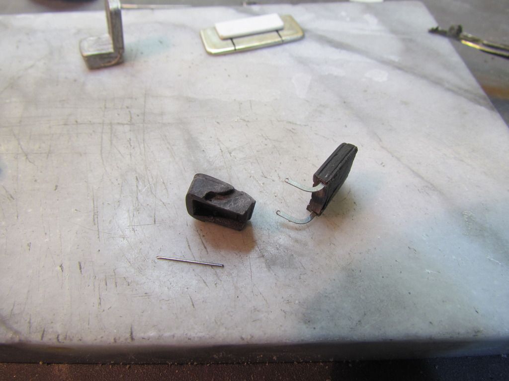

Cut off the backrest:
Cut slots into the backrest and put photo-etched hinges into:
Modifying the seat:
Building together with a thin rod going through all holes:
Working:

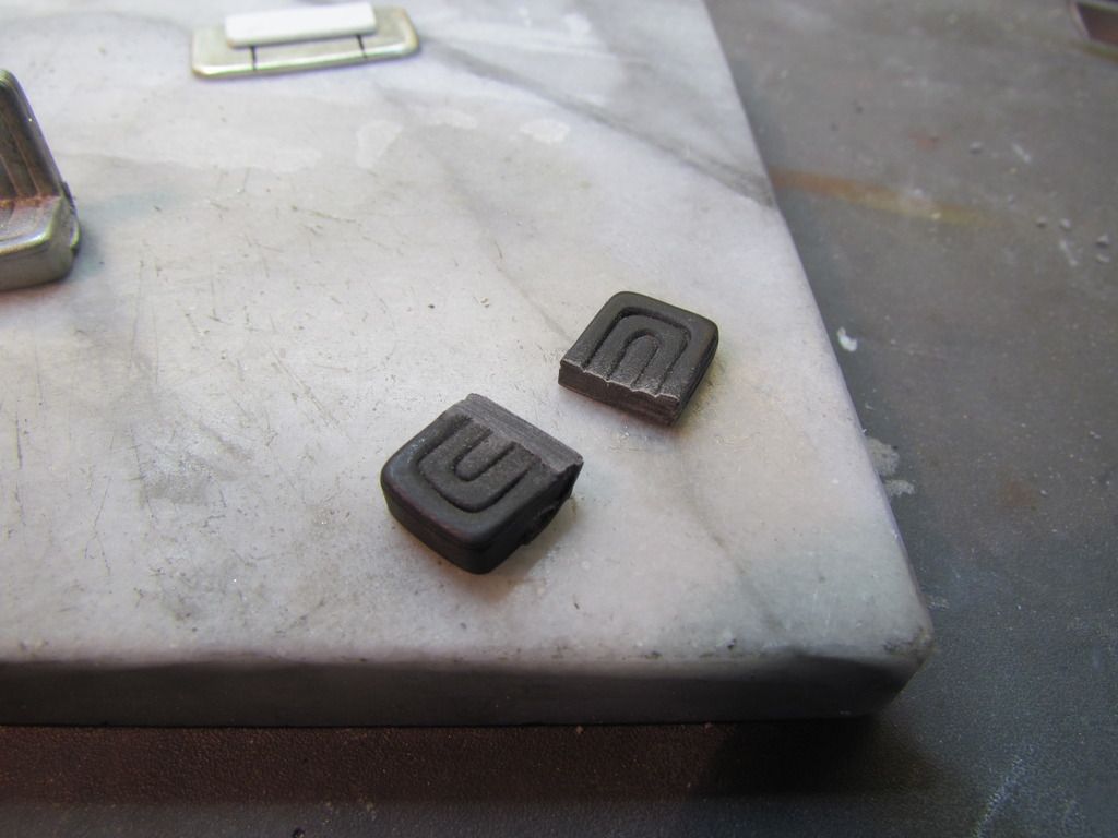

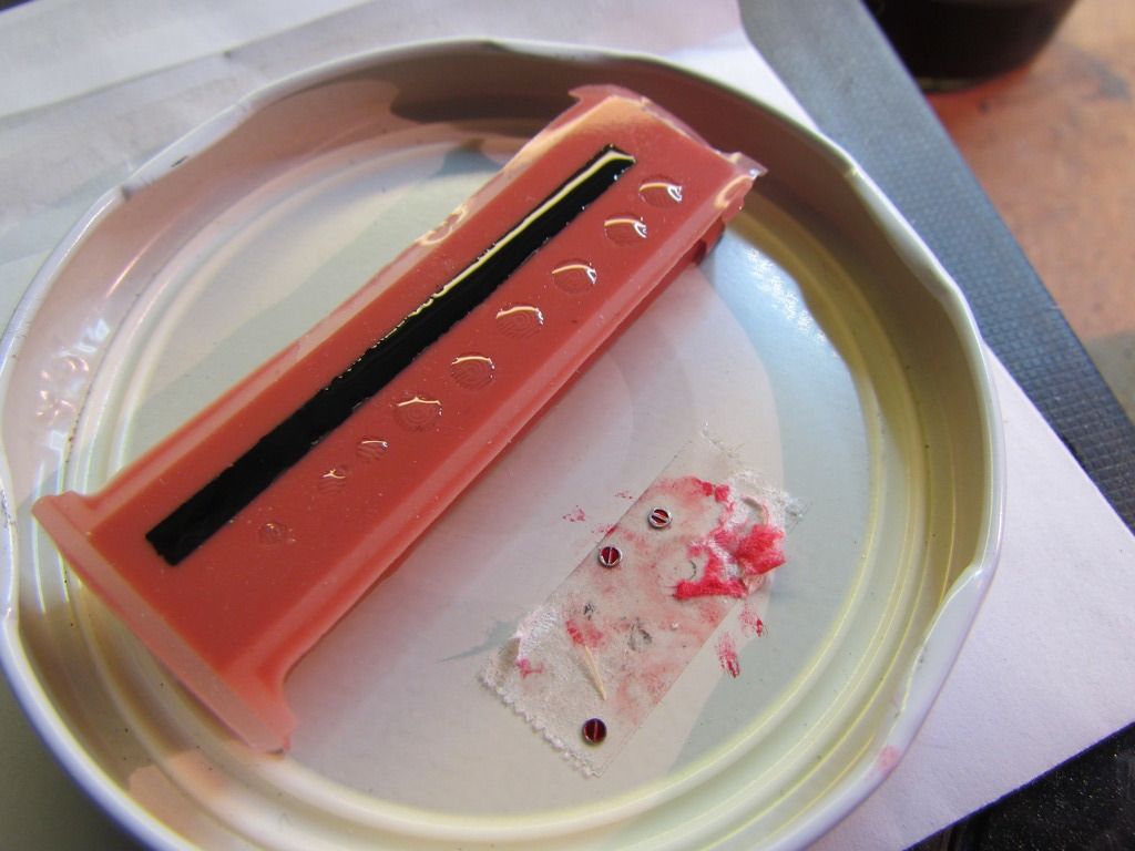

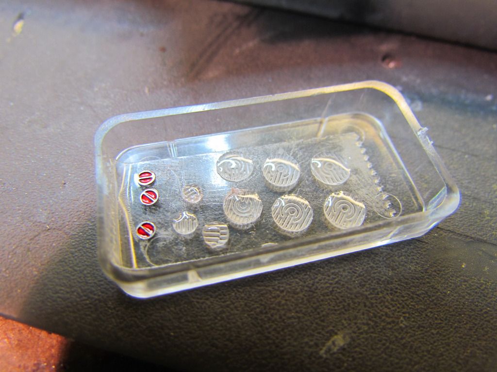

Today I've cast the lenses and the tire profile in silicone and filled this mould with resin, as well as the taillights:

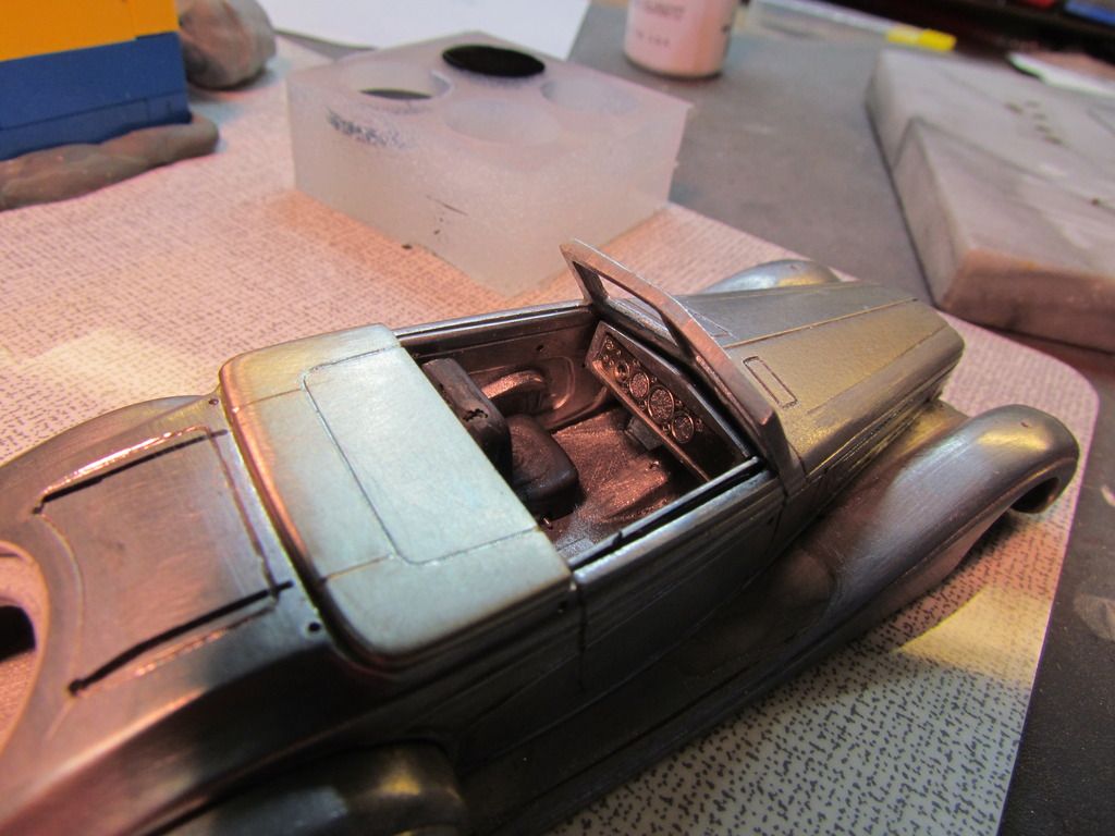

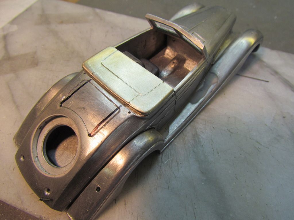

Then, before making the folding seats, all parts for the interior are fixed to see if everything fits:

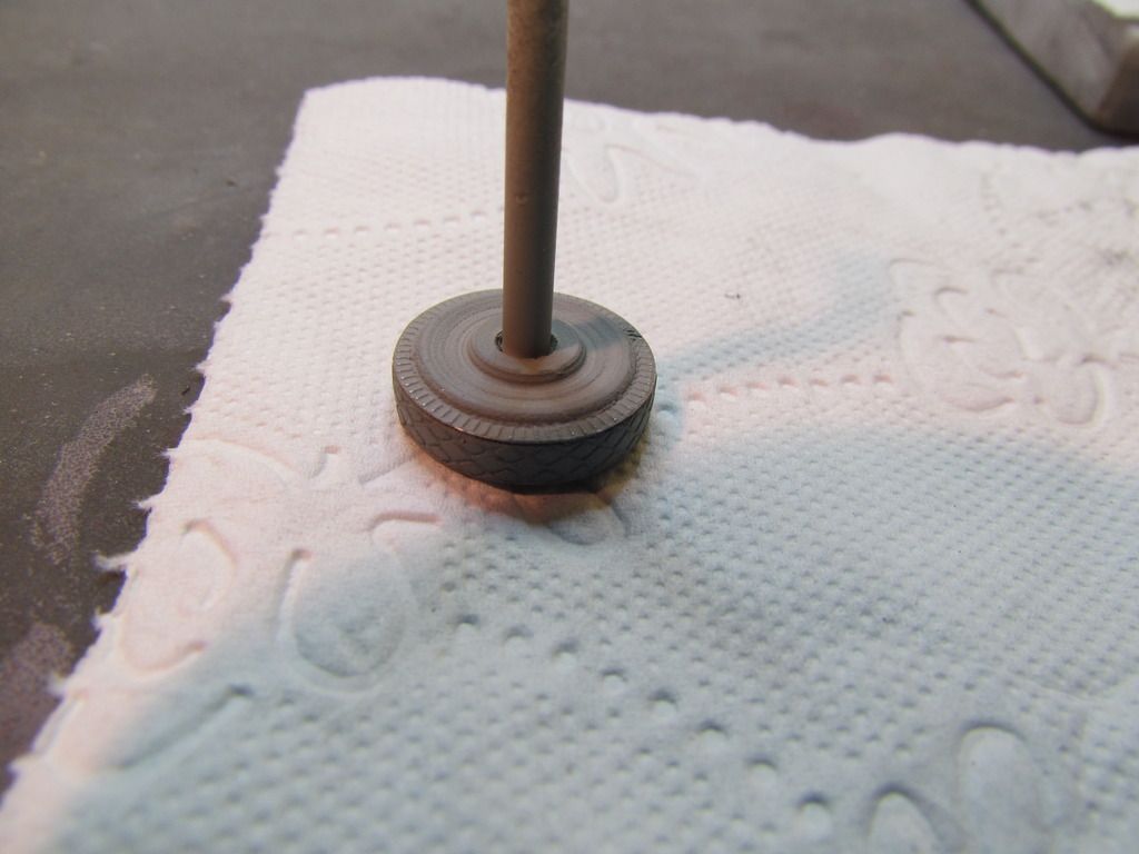

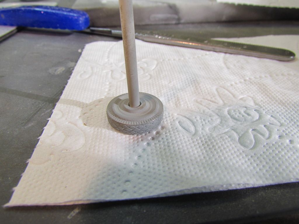

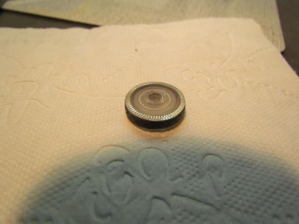

Today I continued with the tires. I already modified the original rubber tires, but I'm not completely satisfied, so I want to try something else:

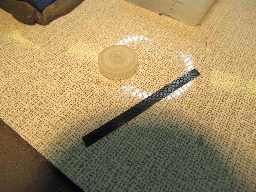

"blank" tire made (partially, at least) on my new lathe and the resin-casted profile from the p/e part:
Running profile and flank profiles glued onto:
First coating with primer:

That's different ! How do you ensure the pattern matches where the two ends of the PE meet ?

Tom wrote:Very cool way to make tyres.
You know, I always aim for being independent from all the suppliers of spare parts etc. And so I use my sleepless nights to think about how all the necessary parts could be made "at home"... ;)
Jager wrote:That's different ! How do you ensure the pattern matches where the two ends of the PE meet ?
Take the diameter of the wheel, multiply with 3.14 ("pi") and you have the length of the profile. In the graphic programme it is no problem to stretch or push the designed pattern exactly to this measurement, and this way the ends fit together. On the other hand: the resin part stretches a little when handling it and glueing it onto the wheel, so the pattern matches not 100%... I'm sure no-one will notice that at the completed car :)

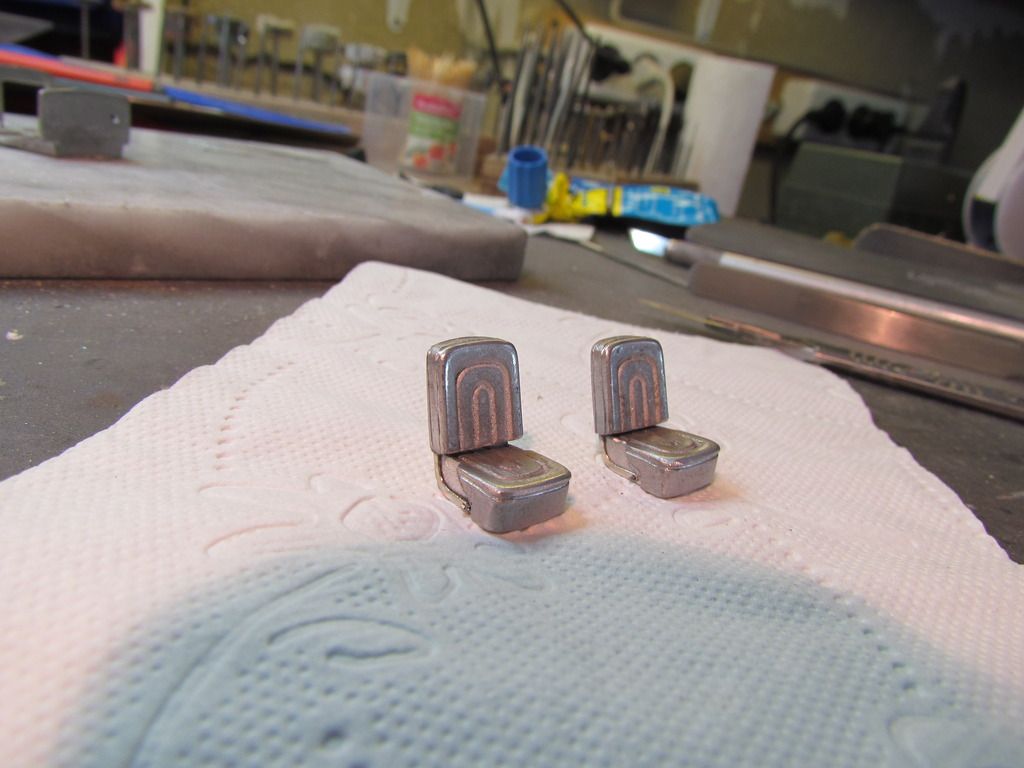

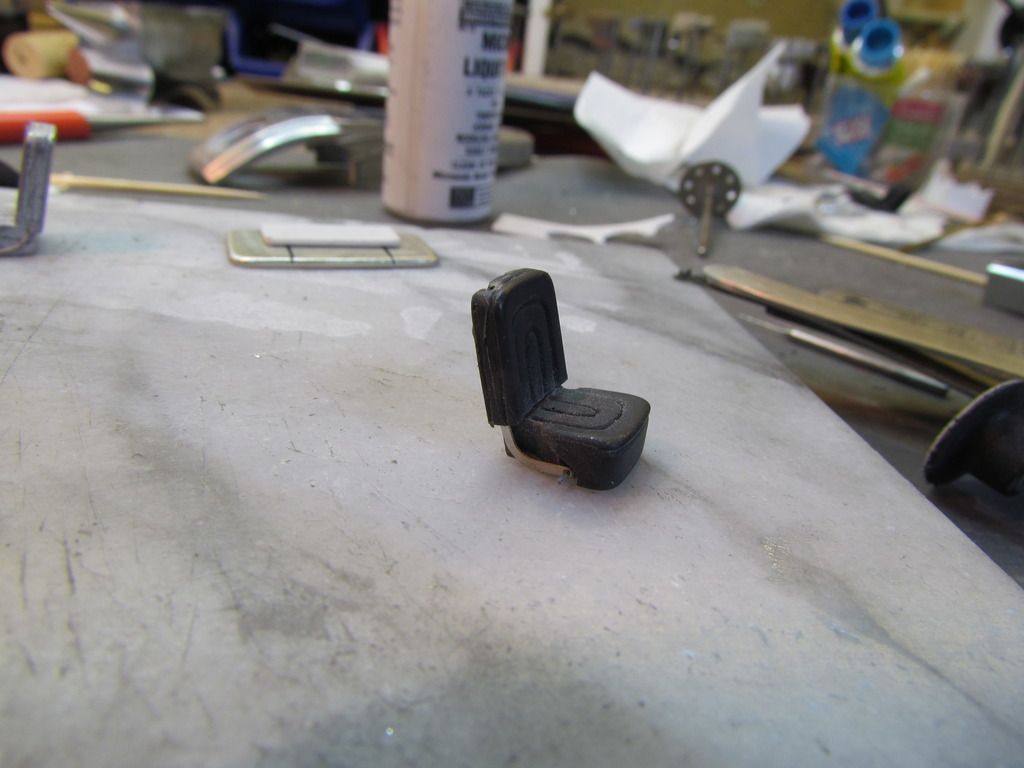

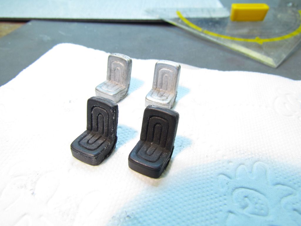

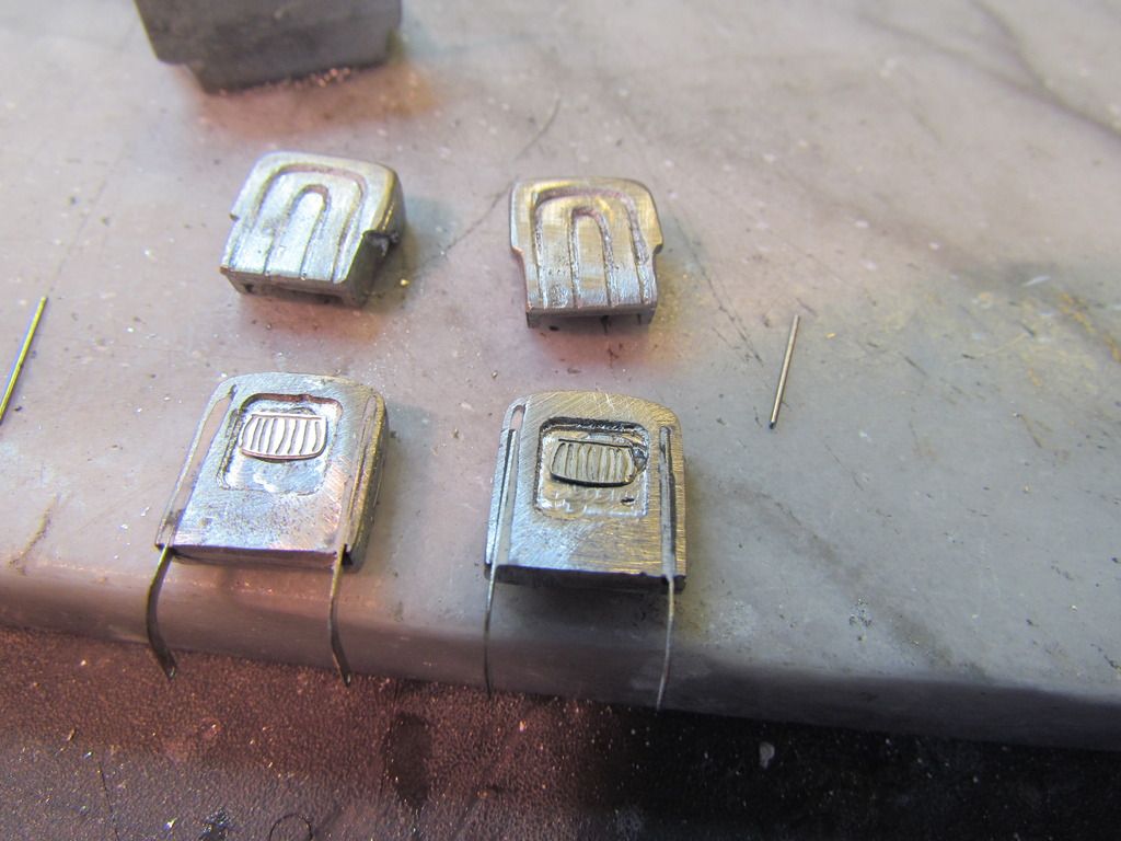

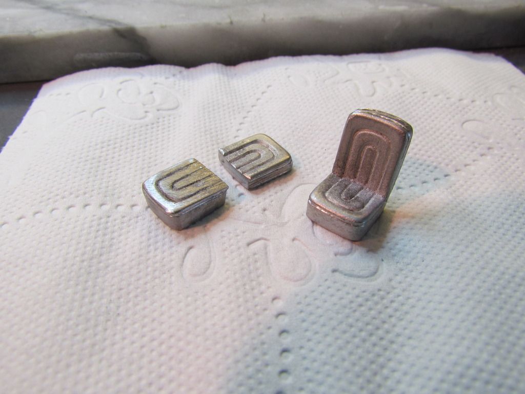

Today I have finally made the folding seats. I was a little bit afraid - while I tried everything with the resin casts first, I haven't made white-metal copies, so every single step MUST be accurate :o So it took the whole day, but I'm very satisfied with the result:

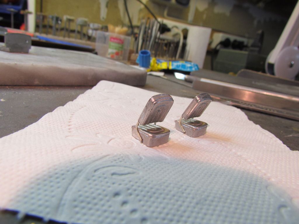

First seat cut into halves:
HInges glued into, smoothened with putty, milled a rectangle cut-out (according to the picture) and added two pockets:
Completed seats:
...and everything works perfectly :P
The lenses for the headlights are meanwhile ready, I always make slightly different sizes, as you can hardly control the exact diameter when milling out the massive headlights:

So you glue the tire thread over the "tire"? But doesn't that leave a seam?

LUW wrote:So you glue the tire thread over the "tire"? But doesn't that leave a seam?
Maybe it does, but I think this won't be visible. Today I've casted the first tire, it takes about three days until the resin has hardened, then we will see how everything will have turned out :)

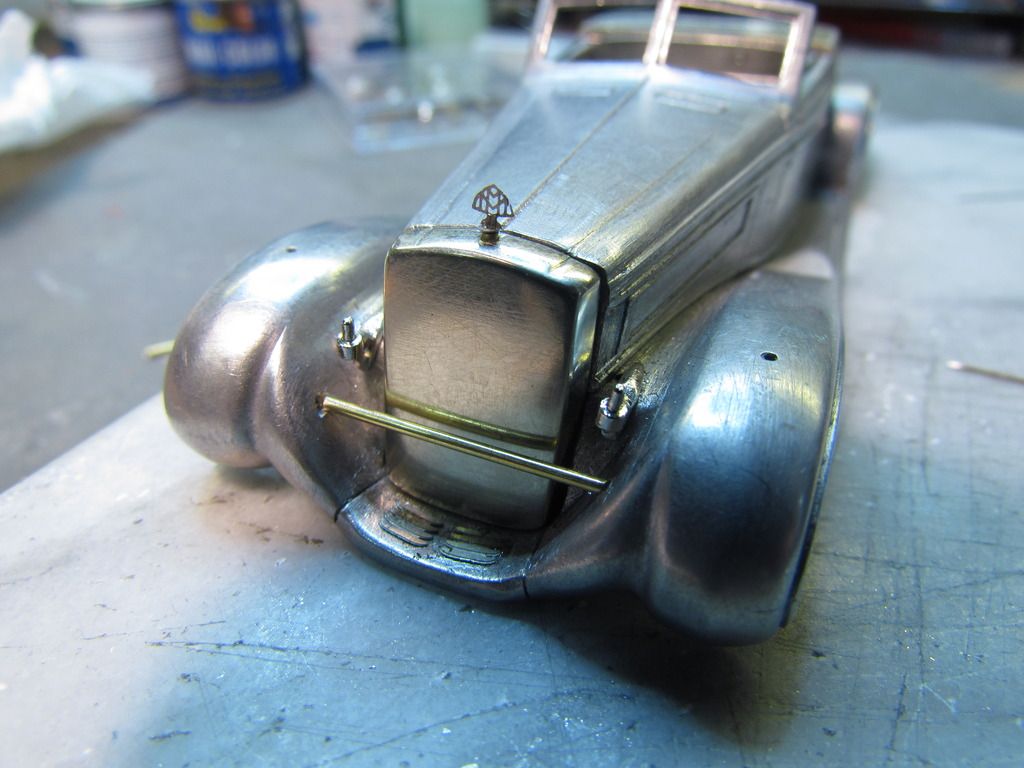

Today some smaller works at the front end have been made. The radiator got a small "cap" and the MM-mascot. The rod for the central headlight was - of course :roll: - too long, but as TinWizard choose the higher position of the "other" version, I simply arranged for a new rod sitting lower. Small louvers were added under the grill:
Tomorrow the grille itself will be prepared for etching the cut-out for the mesh, and slowly, slowly all parts are are adjusted and are ready for priming... :P
