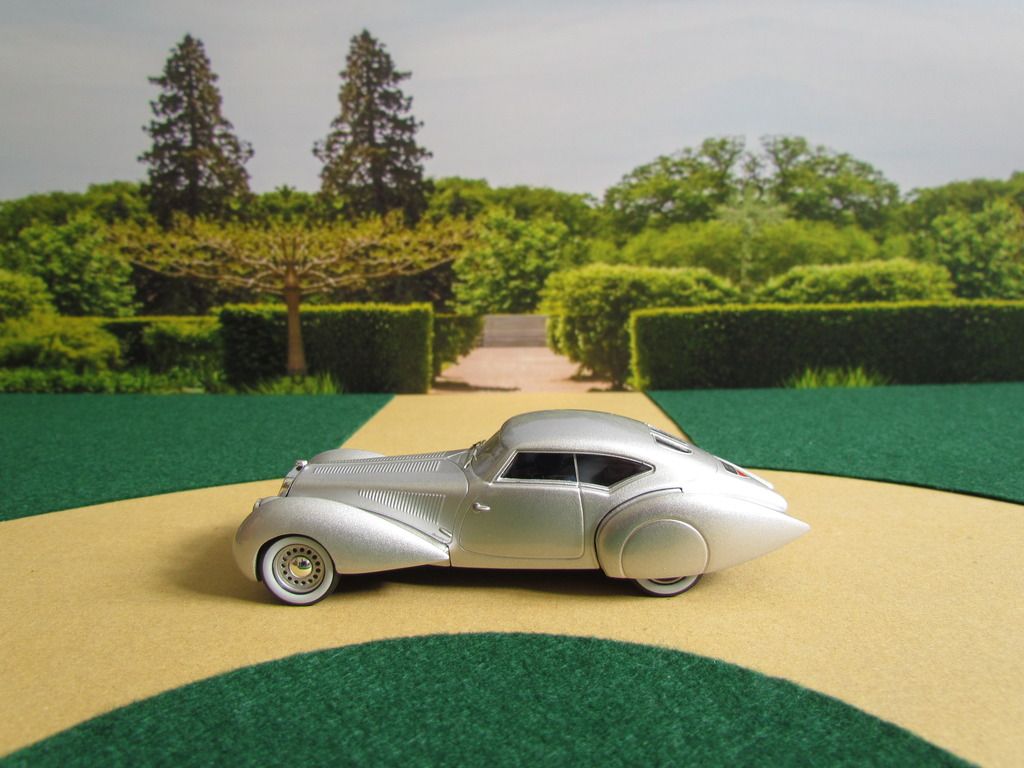

Et maintenant, Mesdames et Messieurs, the "how-to" of building a simple diorama:
First making an outside shell of 5mm rigid foam board (called "Kapa" board). This is useful for making different dioramas, all to be installed in the same way:
Rear board made of 5mm translucent plexi-glass, thus it can be used for rear projections as well as for windows in another (inside) diorama:
Easily connected with so-called "Fisso connectors":
The chosen photos of Cheverny castle were printed directly onto a 5mm rigid foam board with a plastic surface, these are put into the outside shell:
Think of using distance keepers to bridge the gap resulting by the connectors:
The existing plafond with altered lines resp. graphic, because straight lines and correct circles appear distorted on photos. So you have to distort the lines in reality, to achieve a proper impression on the photos :) :
This - of course - now serves only as a sketch which will be executed with the according material...
Here we go:
Accidentally some nice cars came around... ;) :
Next steps will be: making a new plafond and some furniture for decorating the plot. Stay tuned! :P

Jean, it looks MUCH better, a clear improvement!
And why don't you try an outdoor shot? If the sky is cloudy you get perfect lighting without spending a penny.

WOW!
Love the lighting, the depth of field that suggests distance... perfect!

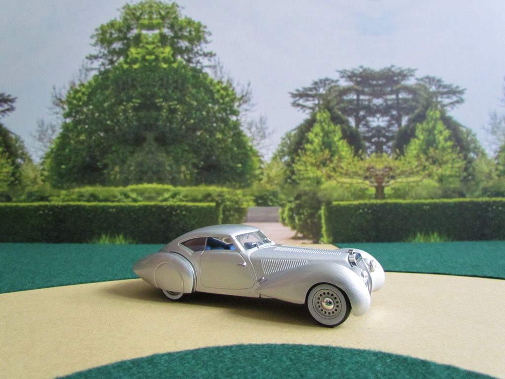

Meanwhile my cellar-room workshop has been tidied up, the new workbench with the machines is installed, so I can continue with the diorama (before building the next car!!!).
The former base-plate is cut into pieces which serve as templates. The new base-plate (hard foam with self-adhesive surface) is already covered with grass from the model railway supply, but only with removable spray adhesive onto the cover foil:
Templates are placed onto the board, cut at the edges through grass and protecting foil, the latter peeled off, the grass in the exact same size placed onto the self-adhesive surface:
Freshly mown lawn:
Reminiscence of my annual holidays, finest sand from the Beach of Amrum in the North Sea:
Applied on the paths:
Some decoration:
...and everything sprayed with a dozen of cans of semi-matte clear lacquer, to fix sand and grass (both causing a lot of dirt :evil: ):
Time to have a look how everything works:
Still have to make further tests with the lighting, as the backdrop looks a little bit hazy, although the photos show a bright blue sky, but I guess this is only the beginning... :lol:

This one!

Love it. The perfect backdrop for your creations.

Beautiful!
A classic meet in an equally classical environment.
