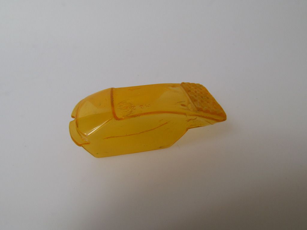

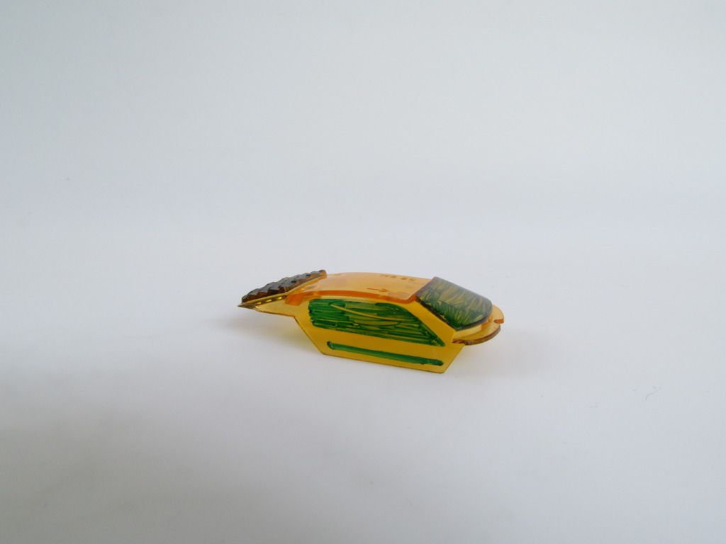

To get scratches out of plastic windows made of hard-plastic I use a set of MicroMesh. With which grade to start depends on how deep the scratches are, normally 2500 should be sufficient, but in the worst case a rougher grade could be necessary. Then you have to polish step by step with all further (finer) grades of damp (!) MicroMesh (3200, 3600, 4000, 6000, 8000, 12000) and finally with MicroMesh Liquid Abrasive and a soft polishing cloth. This way you reach brilliant clear glossy windows - sometimes better than new! ;) This procedure also works best for polishing lacquer. Be very careful with all polishings made for "real" cars: they usually harm the lacquer by solving it, as the model paints are different from "real" car paints.
To show how this works here an example of my workshop:
The windows of a Matchbox Superfast Lamborghini Marzal after heavy child's room use:
... and after the treatment described above:
(The horizontal line is a split from playing with...)
