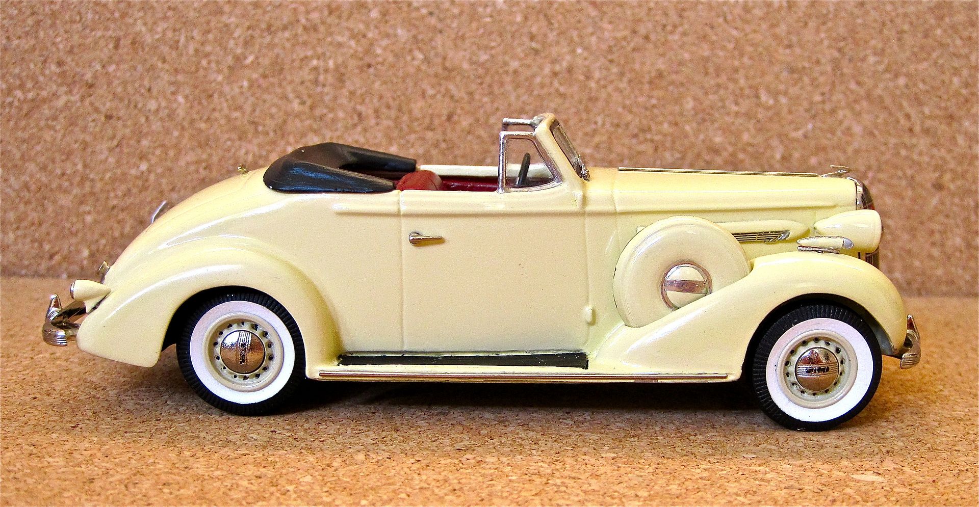

The key to a good paint job is (1) the preparation and (2) the sanding and polishing after painting. (3) Of course a smooth paint job is also important.
A Yellow 1936 Buick, painted using a rattle can, lacquer, and with a gloss clear coat. (sanded and polished the clear coat)
Sanding starts with maybe 300 then 400 then 600 wet/dry paper (on the bare body or on rough paint), very fine steel wool also helps sometimes. Then after smooth paint application, begin using 2400 -> 3200 -> 4000 -> 6000 -> 8000 -> and finally 1200 grit sanding pads (foam backed and bendable). I also use sanding sticks, strips, and rounds of various grits to get around bends and shapes.

I couldn't resist this Brooklin 1936 Buick because the fenders are the same as those on our 1:1 1935 Chevy and it was just plain cute, but it's black paint made it disappear in the display case, so I painted it a happy yellow.
Following shows the rework of the Buick.
I lost the windows after removal so had to recreate them from plastic sheet, a first for me. Am happy with the them but am afraid that they are now very fragile. This model pushed my skills a bit but at some point I decided that it was "good enough" and just put it together. Noticed a couple of things after taking these pics so will correct them with a bit of paint or glue.
I hope you enjoy the pics
The paint was stripped using just a bit of paint stripper (not thinner) in a metal tray being careful not to lose small parts.
The parts were then washed with soap, scrubbed with steel wool, primed, lightly sanded, then painted, and clear coated.
Sanded the clear coat with modelling pads starting with 2400 grit, then 3200, 4000, 6000, 8000, and finally 12000 grit which gave it a nice sheen. Polishing gave it a great shine. IMHO sanding and polishing the clear coat gives the model a more realistic finish.

Since I struggle with getting a great paint job, I'm wondering how you painted this one. Brush, aerosol can, or air brush? I'm learning that it's what you do after painting (sanding, polishing, clear finishes) that can make a big difference in the results. Prep work is also important, I have found.

I used spray cans on this model, a primer, the yellow, and a gloss clear. Usually I use an airbrush because it has better control.
Micro-Mark has all the supplies you might need including sanding pads and sticks of various grades. In fact 12000 grade feels smooth.
Many pro modelers will never use a clear coat because the results are too nice = fake, but clearcoating decals gives a great advantage.
That is why I started sanding the clearcoat with the pads. Decals are protected but a "real" look is imparted to the paint = all is good.
This cars yellow lacquer required a clear coat and sanding/waxing made it look real.
