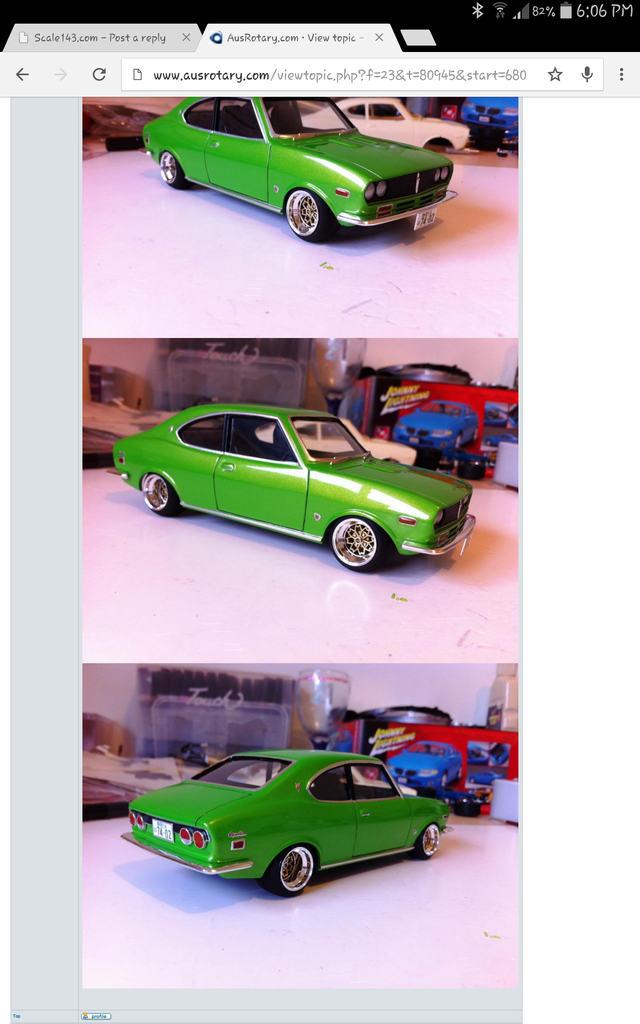

This from a kitset builder on a rotary forum..I asked him specifically whether he used bare metal foil on his brightwork...
"The bumpers in the old plastic kit are chrome and that's what i ended up using, although the ones in the resin kit are slightly thinner and look better. For the resin bumpers I paint them black and use Kousette Ginsan chrome buffing powder, the stuff is magic! I'm still having dramas getting the resin bumpers smooth enough to buff but when i do I'll swap them over."

Lars, Kit? Resin? Spill the beans buddy.
Posts: 3484
Re: Chrome paint
Post by rotormotor » Sat Jun 27, 2015 4:23 am
I think a member on the ausrotary forum makes resin kits...like major bits of the bandai 1/20 r100 kit for sale..maybe also the rx2,3 as well. that rx2 is twin headlight so unknown scale or brand for that one...suspect 1/24.
